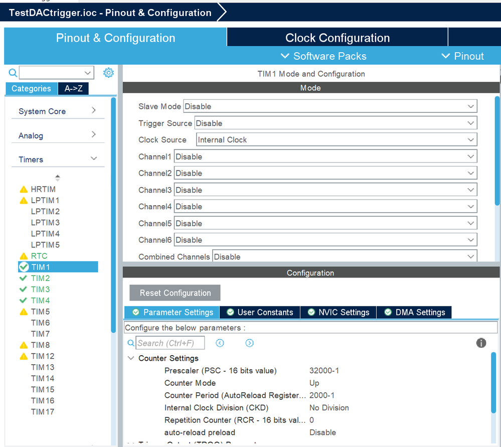

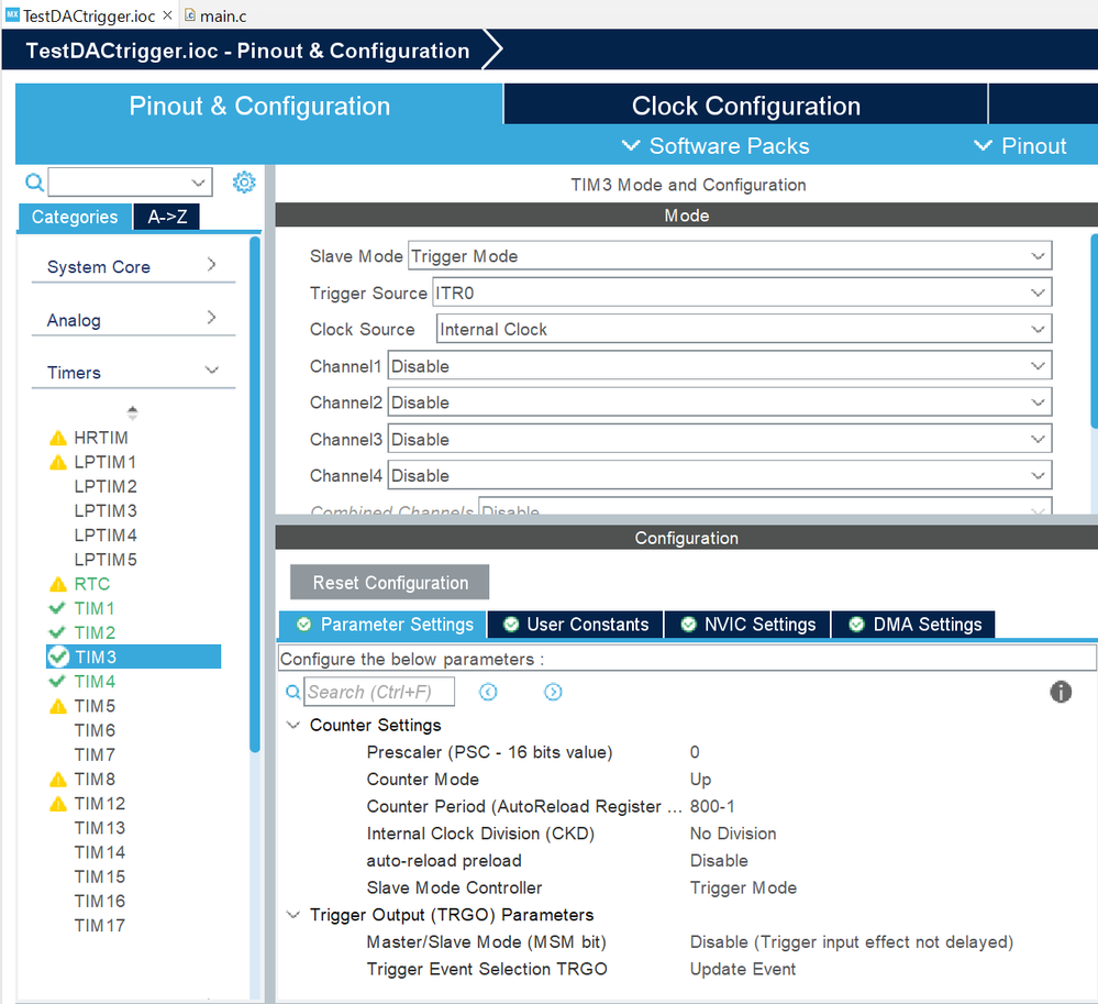

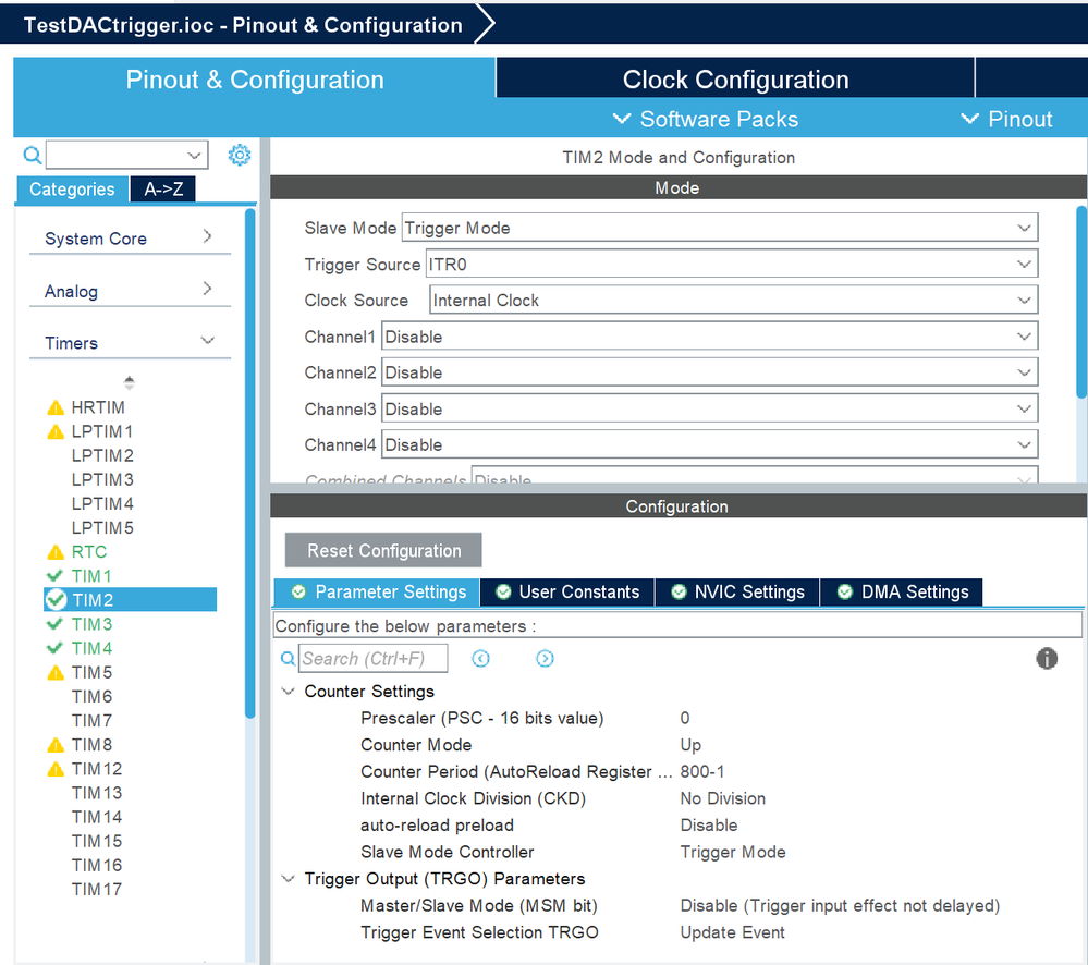

In order to start the ADC and DAC at the same time I use TIM1, running on the internal clock of 32MHz, which after a delay of 2 seconds triggers an event TR0, one pulse mode.
TIM2 is the timer which triggers the reading of the DAC, and is triggered by TR0, reading the DMA buffer for DAC at 400kHz (presc=0, Counter=79)
TIM3 is the timer which triggers the reading of the ADC, and is triggered by TR0, reading the ADC value and writing in the DMA at 40Hz. (presc=0, Counter=799)

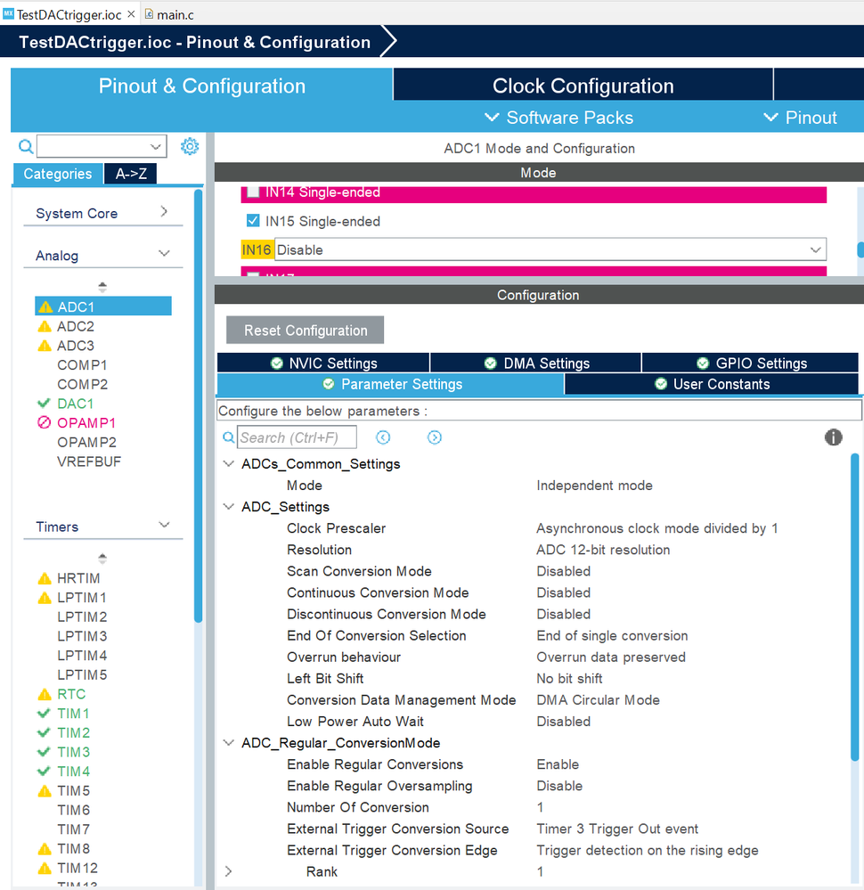

The frequency of the 12bits ADC is 1.2MHz, 12bits, 2.5 sample cycle, prescaler 1.

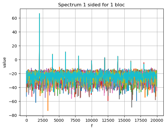

After downloading the data, the spectrum (FFT 1 sided) shows a signal at 2kHz.

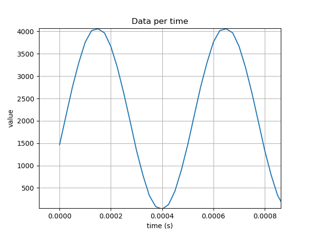

However the phase of the peak (so the phase of the first point of my sine) is not 0° but 260°.
At 2kHz, this is a 361µs delay (or a 139µs in advance) modulo 500µs.
This can be confirmed in the time series: the first point is at 1470, instead of 2048 as the sine is center around 2048.

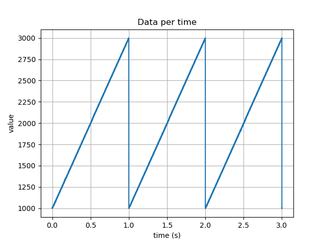

In order to know who is delayed to whom, I made another experiment.
I wrote a 1s ramp starting from the value 1000 to 3000 in order to avoid any saturation around 0 and 4096 in the 12bits DAC.
#define NSramp 2000
uint32_t rampeDAC[NSramp];
for(indice=0;indice<NSramp;indice++){
rampeDAC[indice]=indice+1000;
And I changed the time of TIM2 to a counter period of 799 so the signal last 1 second.

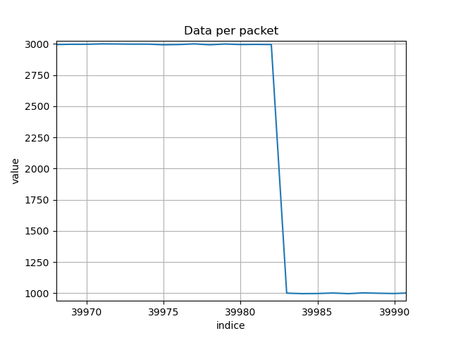

The output shows the ramp lasting 1s.
However the number 1000 doesn't start at 0, 1, 2s but a little earlier, 17 packets of 40kHz which means 425µs.

Your spectrum for 2 KHz sine wave generation shows me a lot of huge harmonics and maybe also a sinc modulation somewhere. Maybe your code writing to DAC and reading results from ADC has a "modulation" effect (when done on same MCU, the SW overhead and "sequential code execution" causing it).

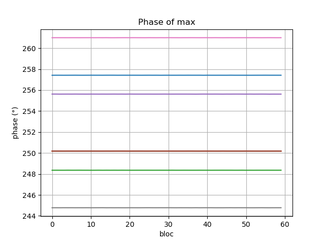

My experiments show that for the same parameters, if I turn start several times the nucleo card, the phase delay will always be the same between the DAC and the ADC.

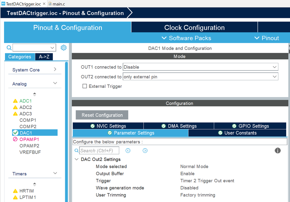

TIM2->CR1 is the control register, but I can configure it in the .ioc file too, right ? (my screenshots in my other post)

For the spectrum of the sine, I forgot to write that the Y axis is in dB, so the harmonics are 50dB lower than the fundamental which is ok for my application.
I can lower the peaks of the harmonics by 20dB by lowering the amplitude because it got saturated near the value 4095.
I would use a filter to have a lower noise but I wanted to focus on the true delay without filter.

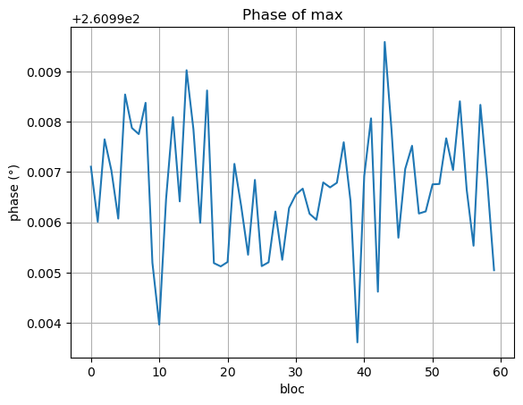

I made a few more tests and it seems like starting hardware timers by an event is less precise than starting timers by writing HAL_TIM_Base_Start(&htim2) in the main.c
Method 1:
DAC is triggered by TIM2
ADC is triggered by TIM3
And I start TIM2 and TIM3 manually in the main.c
//connect sinusDAC to DMA
HAL_ADC_Start_DMA(&hadc1,(uint32_t*)&buffer_adc,DMAsize);
HAL_DAC_Start_DMA(&hdac1, DAC_CHANNEL_2, (uint32_t*)sinusDAC, NSsinus, DAC_ALIGN_12B_R);
HAL_TIM_Base_Start(&htim2);
HAL_TIM_Base_Start(&htim3);
I proceed to run the code and measure the delay of the sampled sinus.
I obtain almost the same phase (around 0.01°=140ns) each time I run and flash the code in the micro-controller.

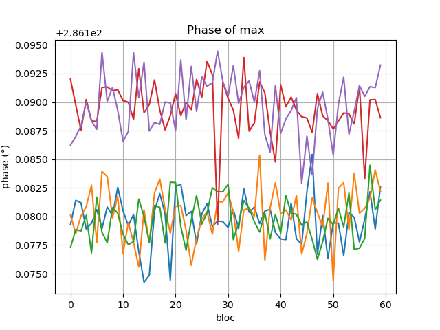

Method 2:
TIM2 and TIM3 are in slave mode and triggered by TIM1.
I start manually TIM1 which is on one pulse mode.
HAL_DAC_Start_DMA(&hdac1, DAC_CHANNEL_2, (uint32_t*)sinusADC, NSsinus, DAC_ALIGN_12B_R);
HAL_TIM_Base_Start(&htim1);
I process the same way as before, run and flash the code several times. I obtain a less precise phase delay each time (17°= 23µs)
I thought starting the hardware the timers by the same event (rising edge of another hardware timer) would lead to a constant offset delay. But on the contrary, it is more precise to start the timer individually in the software (main.c)
