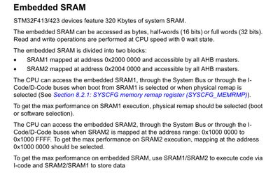

I need your collective intelligence, because I am a bit lost on the information given by the ST datasheets and reference manuals.

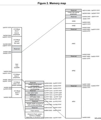

Backstory: on a few of our prototypes we started to see random failing behavior and investigated quite a bit. The faulty behavior seems to start when the stack lies in SRAM2 region. KEILs default linker file has IROM region from 0x20000000 to 0x20005000 which is SRAM1 and SRAM2 together as one region.
Could it indeed be that the Stack in SRAM2 or even over the edge between SRAM1 and SRAM2 could cause faulty behavior? Or is this a dead end?
Which address, 0x1000xxxx or 0x2004xxxx?

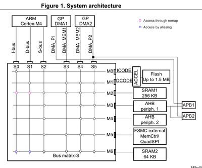

In any case, stack location is unlikely to cause any problems directly, read, it's probably a program error, maybe masked with e.g. somewhat slower execution if processor accessing stack collides with other bus masters such as DMA.

I am using RAM from 0x20000000 to 0x20050000 so 0x2004xxxx.

Thank you for reaching back this Open Thread . It is quite interesting to know the root cause or how to reproduce that faulty behavior ( it seems not on all devices ) so may be due to Timings conflict with Cortex-M4 ? To be debugged . SRAM2 is 64Kbytes is mainly used for have critical Code routine to run with I-code , but is contiguous with SRAM1 so may be there is a multiple Load transaction crossing them .
