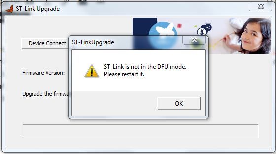

I was just programming my stm32f217 board via serial wire interface and everything was ok, but when I wanted to program once more the message ''No target connected''displayed and it didn't program my MCU anymore.
But when I use IAR to program stm8 it works.
What is the problem?
I tried updating the firmware but the message bellow displayed that I don't know what it is.

You need to review what you are doing with the PA13/PA14 pins in your design, or if you are powering off the device.
