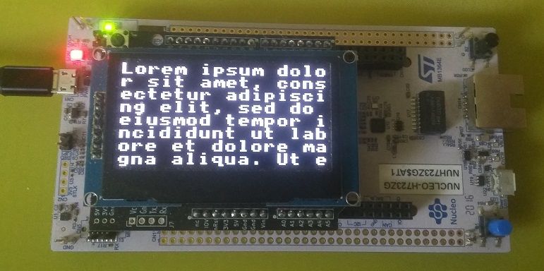

2025-02-16 11:38 AM
>>Let me ask you a straight question Have you worked with this particular micro controller ?
The Cortex-M0?
Yes, I've used SSD1306, SH1106 and SSD1309 via I2C on L0, L4, F7 and H7 among others.
Specifically the STM32F030C8T6TR, probably not, but if I did it wouldn't take 5 seconds to paint the screen.
We're a page deep here, still not clear what pins you've used, the I2C configuration code, or the library you're trying to integrate. It's great it's working on your other platforms, and MCUs, but those are the ones you're trying to debug.
