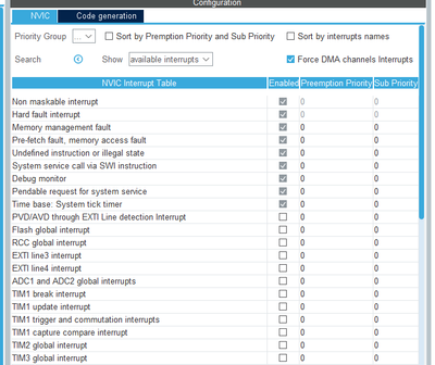

2024-07-20 1:52 PM
If you see the screenshot that i sent, it is already set to 0..

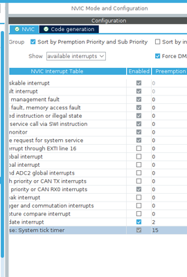

2025-02-20 2:20 PM
The lower the number, the higher the priority is.
Priority 0 is the highest priority. 15 would be the lowest priority.
