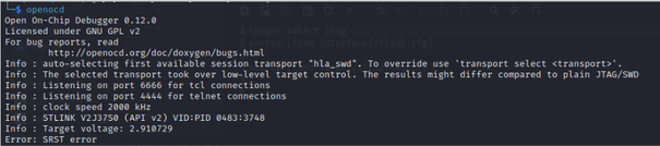

i got a stm32f4 and wrote some code to it, then tried to run openocd and got this error

Did you end up solving your issue? I am currently stuck with the same problem after reprogramming my stlink with jlink firmware and then back to stlink.
2024-12-17 9:00 PM
Never mind, I resolved the issue by updating the ST-Link using ST's STLinkUpgrade tool. This resolved the problem.
