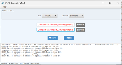

I am trying to convert the SPL to LL using the SPL2LL converter. After pressing the migrate button, I got the message below. Please help. Is it the problem that I chose the wrong directory? I chose the directory where the main.c file is located (./). All the others' ./apps are stored in /app.

Dear Tesla and Andrew,
I removed the space, and no special characters were on the path. There are still error messages.
Is it the problem of Strawberry Perl? I installed ActiveState Perl and Strawberry Perl at the same.
2024-05-14 3:12 AM
After installing the older version of Perl, I can run the SPL2LL converter now.
Thank you so much.

However, the errors you posted in the OP don't seem to be about failure to find your source files - they look more like errors in the utility itself.

Dear Andrew,
I used the old Perl version. The higher version is not supported.
