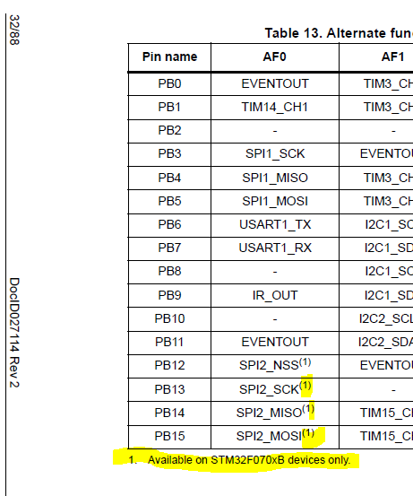

Hello!
What is your device exactly?
As you can see AF0 SPI2 is available on F070xB devices
Regards.
vf
2017-10-04 8:50 AM
hi,
i am using stm32f070 device. i know that its available on AF0 as you can see in my design. i am using AF0 for SPI2.

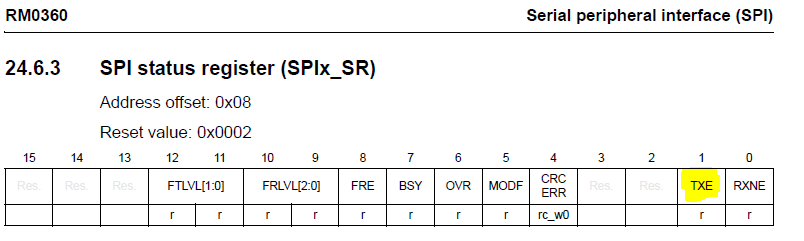

while (SPI_I2S_GetFlagStatus(SPI2, SPI_I2S_FLAG_TXE) == RESET);SPI_SendData8(SPI2, data);while(SPI_I2S_GetFlagStatus(SPI2, SPI_I2S_FLAG_RXNE) == RESET); return SPI_ReceiveData8(SPI2);}2017-10-05 1:37 AM
Hello again.
As i understood code stops at the second while function (wait for RXNE).
It is not normal. Errata sheet not mention something similar.
If is possible, post CR1, CR2 and SR registers, when while loop stucks.
2017-10-05 7:56 AM

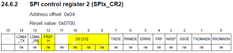

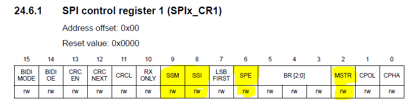

register value is
CR1 = 0x0344
CR2 = 0x1700
SR = 0x0002
2017-10-05 12:03 PM
Hello again.
The values are normal. No interrupts enabled, no error flags, no DMA...
May be a faulty part .
