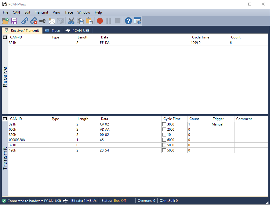

We use can transciever on board which is SN65HVD233MD.. My can bus speed is 1M/bit. I can transmit but can't receive.. I completely close filter.
When i send message from PCAN-View, my interrupt not triggered and Status is ''Bus-Off''
2017-10-03 1:18 AM
I completely close Filter Configuration. But nothing change :\

Yes, i try. No problem when i just transmit packet. But i try to receive, interrupt does not trigger and HAL_CAN_Transmit stop the work and call Error Handler();
My hal libraries may be incorrect? stm32f7xx_hal_can.c? I added this code to library to work together transmit and receive :
__HAL_UNLOCK(hcan); (inside HAL_CAN_Receive_IT())
