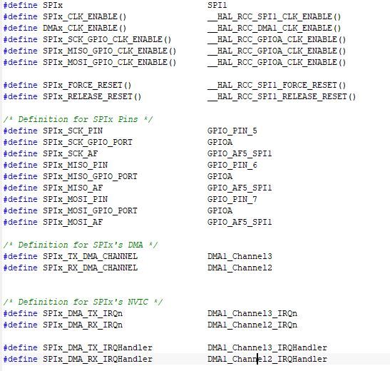

2020-03-06 7:18 AM
2020-03-06 7:19 AM
This is the configuration of SPI1 pins used.
