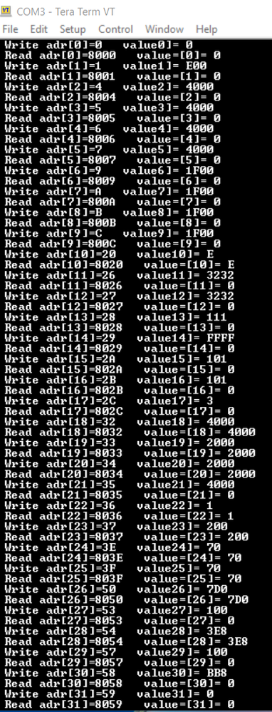

I am working on STM32h7 controller. I configure the AD9106 DAC to SPI. When I tried to write read the configuration register some some registers are get read write and some not why these happening I check the register they are read write able also I changes the SPI frequency low to hgh. For DAC external clock is 150MHZ and SCLK is 4MHZ.

I check on PICOSCOPE. But when I tries to read that particular registers I get the value 0 .

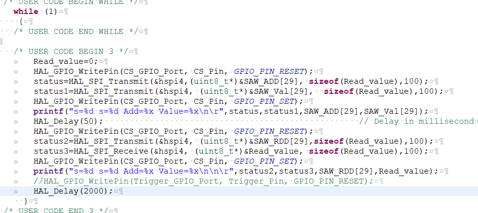

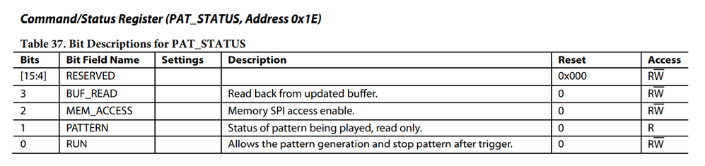

I tried to make the RUN bit 1,but when I read back I get the zero.Why these happening.Here is my code.
Can you me help me.

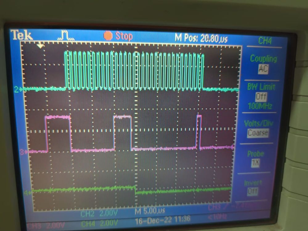

Can you please elaborate the things means what thinks I need to do ?There are two DACs are connected to the SPI4. MOSI ,MISO ,CLOCK are same. Right now I just try to access the DAC1 and for these I make the CS pin HIGH of the DAC2 through out the execution..
In these picture of waveforms I tried to write and read back the address of 1E RUN bit.
Write address=0x001E
Read address=0x801E
Value=0x0001;
