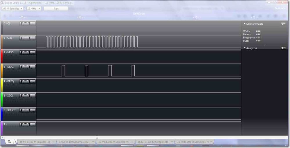

Guys,
I tried to send data via SPI and DMA but can not get a proper data sent... I can't see CS up and down as well..... code:void Mp3WriteRegister(unsigned char addressbyte, unsigned char highbyte, unsigned char lowbyte)

Mp3WriteRegister(0x03,0xC0,0x00);
XCS = PA4
XDCS = PE8
XRESET = PE9
DREQ = PE7
XCS = NSS
