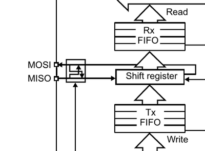

on full duplex spi, always both happen together, transmit and receive, see rm :
