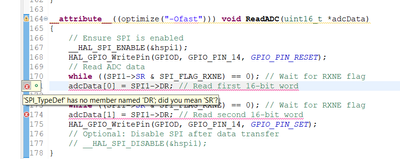

So as your post i want to read direst data register. but i got folloeing errors.

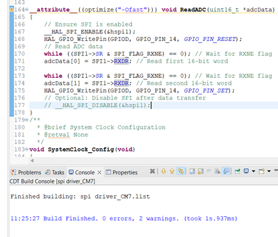

So instead of DR i used RXDR then error solve but output not getting . sclk and cs also not generated means code block at while (( spi1--> sr  line no.170. if i comment line170 to 174 then sclk generated properly
I used setting in stm32cubeide about pin declaration and mode setting, presclare clock and used code generated by stm32cube code generator. so please can you help me where i wrong. i want receive only master.
I need to set pins, mode, clock , presclare all also with register?    Please any example code you have then please can you

__attribute__((optimize("-Ofast"))) void ReadADC(uint16_t *adcData)
    // Ensure SPI is enabled
    __HAL_SPI_ENABLE(&hspi1);
    HAL_GPIO_WritePin(GPIOD, GPIO_PIN_14, GPIO_PIN_RESET);
    // Read ADC data
    while ((SPI1->SR & SPI_FLAG_RXNE) == 0); // Wait for RXNE flag
    adcData[0] = SPI1->RXDR; // Read first 16-bit word
    adcData[1] = SPI1->RXDR; // Read second 16-bit word
    HAL_GPIO_WritePin(GPIOD, GPIO_PIN_14, GPIO_PIN_SET);
    // Optional: Disable SPI after data transfer
    // __HAL_SPI_DISABLE(&hspi1);
  /*Configure GPIO pin : PD14 */
  GPIO_InitStruct.Pin = GPIO_PIN_14;
  GPIO_InitStruct.Speed = GPIO_SPEED_FREQ_VERY_HIGH;
  HAL_GPIO_Init(GPIOD, &GPIO_InitStruct);
/* USER CODE BEGIN MX_GPIO_Init_2 */
/* USER CODE END MX_GPIO_Init_2 */
/* USER CODE BEGIN 4 */
PUTCHAR_PROTOTYPE
	/* Place your implementation of fputc here */
	/* e.g. write a character to the EVAL_COM1 and Loop until the end of transmission */
	HAL_UART_Transmit(&huart3, (uint8_t *)&ch, 1, 0xFFFF);
	return ch;
/* USER CODE END 4 */
  * @brief  This function is executed in case of error occurrence.
  * @retval None
void Error_Handler(void)
  __disable_irq();
  while (1)
#ifdef  USE_FULL_ASSERT
  * @brief  Reports the name of the source file and the source line number
  *         where the assert_param error has occurred.
  * @param  file: pointer to the source file name
  * @param  line: assert_param error line source number
  * @retval None
  /* USER CODE BEGIN 6 */
     ex: printf("Wrong parameters value: file %s on line %d\r\n", file, line) */
  /* USER CODE END 6 */
#endif /* USE_FULL_ASSERT */
share?
Reduce the prescaler to make it clock faster.
Move more than a single word to get any bandwidth advantages.
