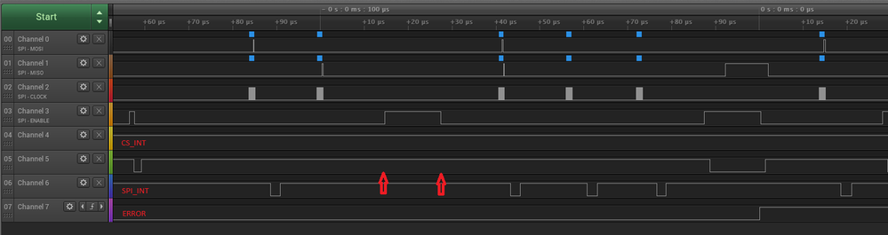

]1. Worst case: EXTI + SPI interrupt is missing:

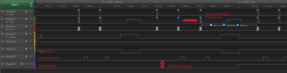

2. Here we can see how often this error occurs - when doing the 2 byte thing continusouly

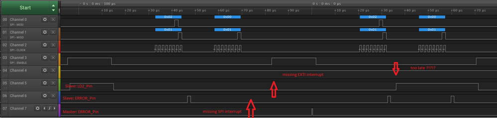

.3 In a more complex scenario sometimes just the SPI interrupt is missing:
Since this was a 2 byte read request - the answer in being send 1 byte too late and leads to corrupted data (0x0001 indead of 0x0101)

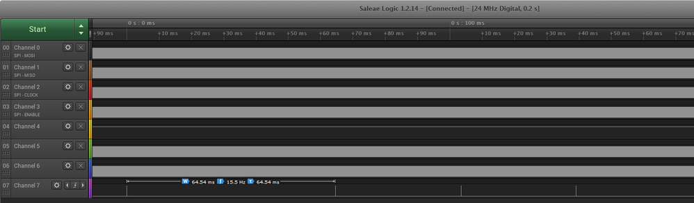

4. This also might happen in between:

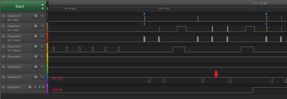

5. Or just the EXTIs are skipped andd SPI is totaly fine:
