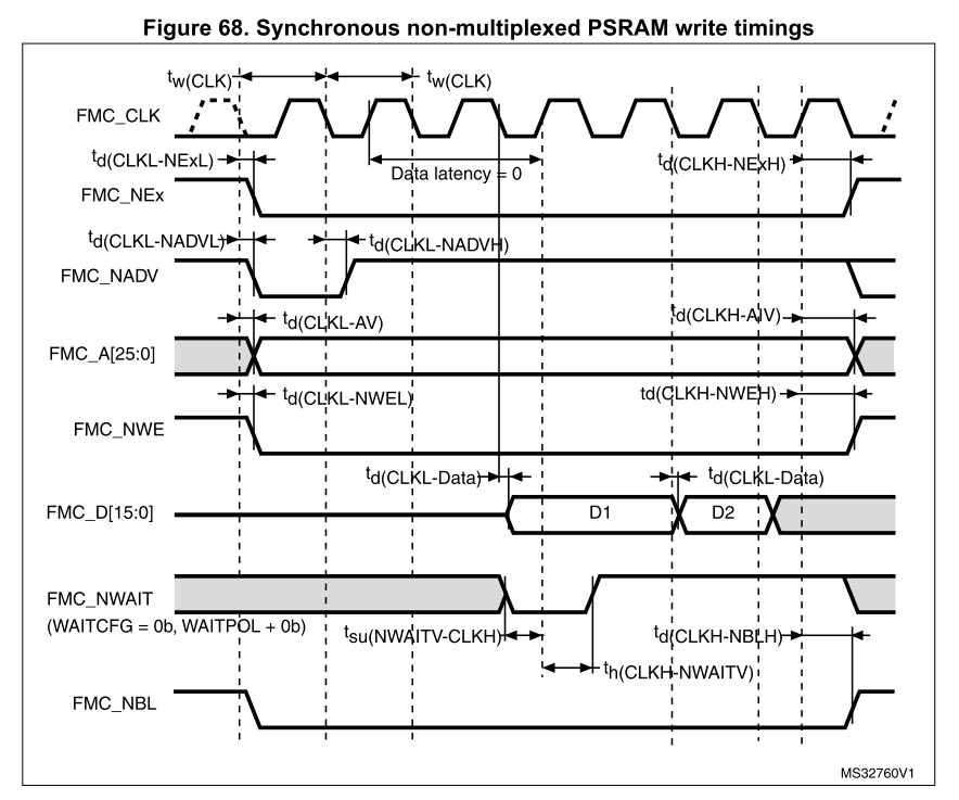

Just see Figure 68. Synchronous non-multiplexed PSRAM write timings
In my opinion there is error in Data latency value - it should be 2
