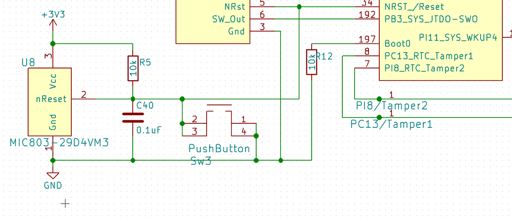

2018-06-10 12:15 AM
if you have to use a reset chip,
this one works well 2.94V threshold and 1.2S delay.

Thanks for the suggestion TJ. I'll work it into the next design as a backup. It can be unpopulated if I can figure this out otherwise.
