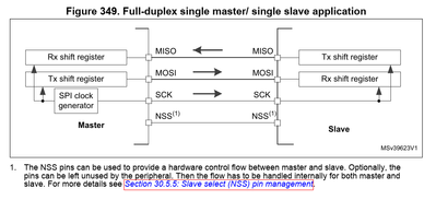

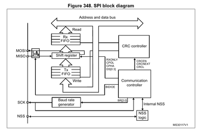

Notice that your two diagrams present different answers to my question.
In Figure 349, the slave has a "Tx shift register" and an "Rx shift register". In this scenario, once a byte has been written into the Rx shift register and sent out over MISO, there will be nothing left in the Rx shift register and it will send zeroes on subsequent clock cycles. That's not what's happening so this figure is not accurate for the STM32.
In Figure 348, there is a single "Shift register" and it pulls data out of a "Tx FIFO" and into the Shift register so it has something to send over MISO. This fits with what I'm seeing, if the STM32 simply recycles the contents of the Tx FIFO instead of clearing it out. That makes sense, the designers of the STM32 had two choices:
1) When the Tx FIFO is empty, send zeroes
2) Don't check whether the Tx FIFO is empty or not, just send the next byte
Option 2 is less silicon so probably a better choice.
So for my program, if I write a 0x00 into pspi->Instance->DR every time I don't have something else to send, it seems like that will zero out the Tx FIFO so the STM32 will not send old bytes.
