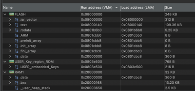

2024-04-10 8:33 AM
This is the memory details. however even if I have the starting address as 0x20003650, The build analyser still does not show the change ram1 in usage and I do not know how use ram2 for usage. Is there a function for enabling ram2 or is there something else I'm doing wrong?
2024-04-10 8:48 AM - edited 2024-04-10 8:49 AM
So your .data begins from 0x20000000 and at the same address you place the heap. Seriously?
No need to "enable" RAM2. The linker does not know that you use it. This is ok.
