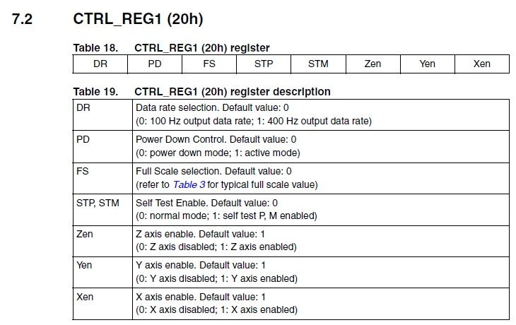

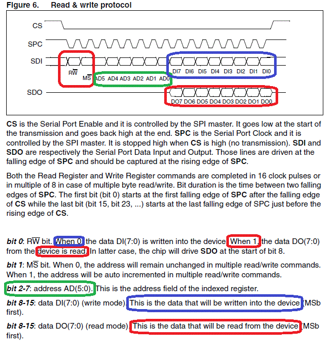

I guess you could look at the bit waveforms described in the
http://www.st.com/web/en/resource/technical/document/datasheet/CD00135460.pdf
, and review the register bit settings. 0x20C7 - Write value 0xC7 into register 0x20 (CTRL_REG1) 0xAB00 - Read value from register 0x2B (OUT_Y) 0x00 (WRITE) + 0x20 (CTRL_REG1) = 0x20 0x80 (READ) + 0x2B (OUT_Y) = 0xAB The high order byte is the Command, and Read/Write direction, the low order byte is the value to Write if sending data to a register.2014-09-03 2:42 AM
2014-09-03 7:34 AM
You're going to need to get a lot sharper if you plan on doing this as a career.
0xC7 because I guess you want the device powered up, output high-rate measurements, and want the X, Y & Z channels enabled?We’re moving the ST Community to a new platform to give you a better and more reliable community experience.
