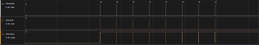

When I run this firmware on my board I get the following output on my logic analyzer:

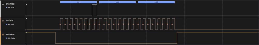

Zooming into the first transmission I see that following :

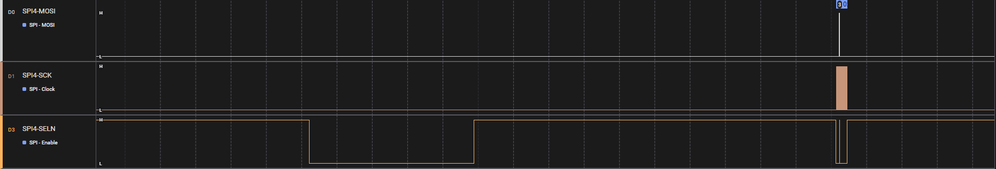

The data seems to be sent as expected. What is strange is the multiple transmissions shown in the first screen capture. If I zoom into the second transmission I get the following:
The select line seems to drop out and then the select line is pulled high again part way through the second transmission. I have attached the .sal file from the logic analyzer as well as a csv file containing all of the data below as well in SPI_Transmit_Issue.zip
My current theory is that the processor is resetting for some reason. When I add a break point to the on the HAL_SPI_Transmit_IT function It is reached multiple times even though main should get trapped in the while loop performing ADC captures.

I ended up figuring out the Issue. IWDG1 is activated by default when generating the Hal files, disabling it fixed my issue.
