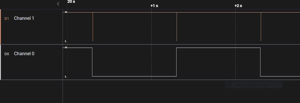

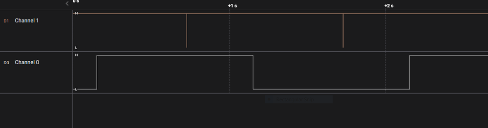

I try to count 1second 10 MHz high accuracy crystal oscilator with stm32f030cst6.Timer starts GPS based clock falling edge(starting paint of my system, Line 65). However, the system is constantly shifting from the starting point
Thats my calculation ;
152*65535+38680 = 10000000
channel 1 : GPS based clcok 1 second
channel 0 : My 1 second
After a while ;
What do you think :grinning_face_with_sweat: ? Thanks
