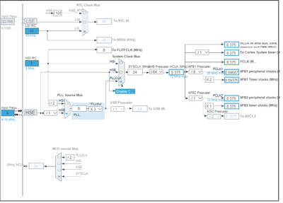

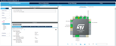

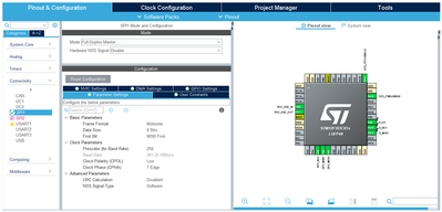

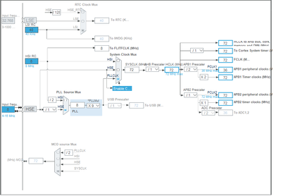

Master configuration :
Slave configuration :

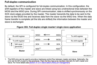

see ->
So try using: HAL_SPI_TransmitReceive(..) in master, to do the data "loop exchange"
and in slave also , giving the data to transmit and wait for ready .
(You cannot separately send or receive , as you tried before. )

2024-02-12 3:20 AM
Thanks that's working but my variable is stuck to 170 and don't move on my screen, and i have a question the frequency of my two cpu does influe on my spi connection ? i can have on my slave 93.5kHz and 72 MHz on my master ?
2024-02-12 3:29 AM
@Skyy_Tsuki wrote:the frequency of my two cpu does influe on my spi connection ?
An SPI connection includes a clock line: the Master provides the clock to the Slave - so, in principle, the internal clock speed of the processors is irrelevant.
@Skyy_Tsuki wrote:my slave 93.5kHz and 72 MHz on my master ?
Really? Your Slave is 93 kilo Hertz?? That's extremely slow!!
If it's really running that slowly, that's going to severely restrict the maximum SPI rate that it can cope with.
You just need to ensure that your SCK rate is within the capabilities of the slave.
