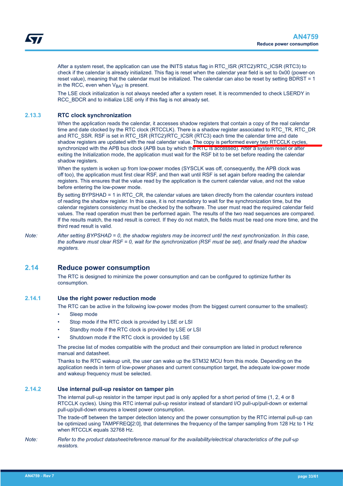

And other place say that it actually happens every other RTCCLK cycle:
34.6.7, 36.6.3: "Calendar values (when reading from RTC_SSR, RTC_TR, and RTC_DR) are taken from the shadow registers, which are updated once every two RTCCLK cycles."
I assume that "every two RTCCLK cycles" is correct, because some other Reference Manuals state this consistently.

The shadow registers are updated every ck_rtc cycle on RTC2_v2_0 and all versions after that.
I think it was "every two cycles" for v1.
So, "every two RTCCLK cycles" is wrong and should be “every RTCCLK cycle�?.
Hope this answer your question.
This means to fix virtually every STM32 RM, except RM0008, isn't it?
And also AN4759
(and yes, I still consider "modern feel and look" wrong.)
Also, AN4759 should mention in this very chapter the RTC v2 lock bug.
Jan
