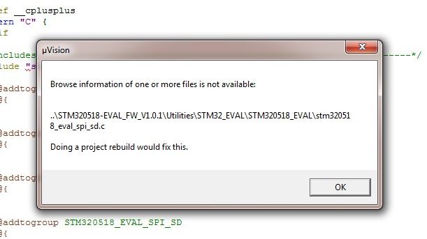

Dear Sir,
Can you advice me how should I include ''stm320518_eval_spi_sd.c and '' stm320518_eval_spi_sd.h'' files to my project. I am using STM320518-EVAL_FW_V1.0.1 ''I tried several manner but it is giving errors2015-01-18 5:40 AM
You can't right click or float on things until the editor has browsing information generated by a compiler pass.
Focus on the errors generated during the build process, starting with the first ones.2015-01-18 6:29 AM
Dear Sir
Only one Error is showing, which is..\STM320518-EVAL_FW_V1.0.1\Utilities\STM32_EVAL\STM320518_EVAL\stm320518_eval.h(39): error: #5: cannot open source input file ''stm32_eval_legacy.h'': No such file or directory2015-01-18 6:58 AM
Which would seem to be indicative that you haven't set up the compiler's include paths sufficiently to capture the needed files, or copied/ported the files to your own project directory(s).2015-01-18 7:13 AM

But it's complaining about another file, stm32_eval_legacy.h, which you evidently didn't copy, or suitably path.
2015-01-19 7:18 AM
Dear Sir,
