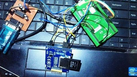

Dear Sir,
I connected MOSI pin to MISO by wire the configure following code then the system is working. My next experiment is connect the SD card to MCU Any advicevoid Send_Data(){

Dear Sir,
I connected my SPI program to SD card (4GB Micro SD card inserted to big SD card socket )while (SPI_I2S_GetFlagStatus(SPI1, SPI_I2S_FLAG_TXE) == RESET);
SPI_I2S_SendData16(SPI1,0x44);
while (SPI_I2S_GetFlagStatus(SPI1, SPI_I2S_FLAG_RXNE) == RESET);
temp = SPI_I2S_ReceiveData16(SPI1);
After sending data as above program ( sent data is 0x44) then I read the sd card using hex editor but hex editor does not show anything
Please advice, Am I on correct track???
2015-01-11 6:23 AM
After sending data as above program ( sent data is 0x44) then I read the sd card using hex editor but hex editor does not show anything. Please advice, Am I on correct track???
The protocol for writing to blocks of data on the SD Card is significantly more complication than that.http://wiki.seabright.co.nz/wiki/SdCardProtocol.html
