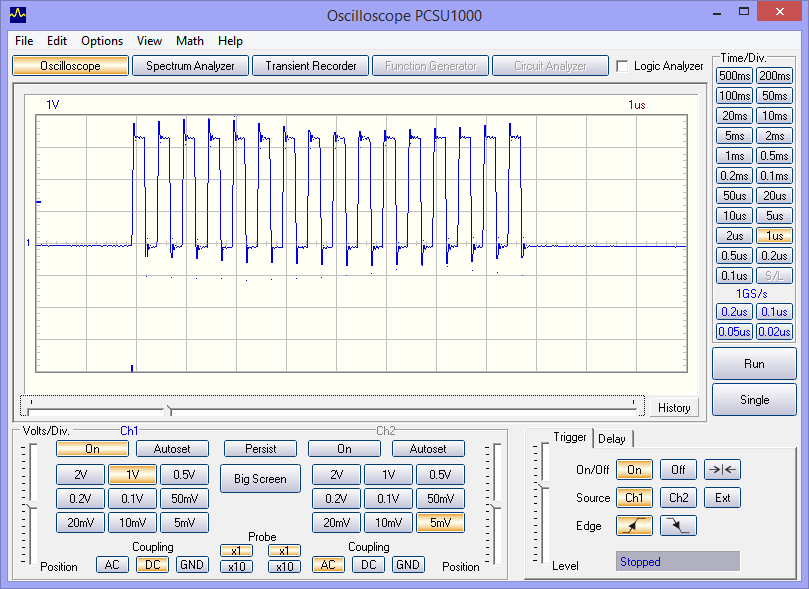

So I'm having a peculiar problem with the SPI on the STM32F072.I'm trying to configure SPI1 and it seems to work, but with one cave-eat. I can't seem to configure the bit size (SCLK) down to 8b from 16b. I've been trying to do it through the CMSIS initialization structure but the changes aren't having any effect, so I've also tried it directly in the configuration registers. Still no luck.The part where I tried configuring the registers manually: SPI1->CR2 &= ~(1<<11);SPI1->CR2 |= 0x700;
SPI1->I2SCFGR &= ~(1<<10);
SPI1->I2SCFGR &= ~(1<<11);As you can see I've also thought about having the SPI configured in the I2S mode, but this doesn't seem to be the case.
SPI_Cmd(SPI1, DISABLE);
SPI_InitStructure.SPI_BaudRatePrescaler = SPI_BaudRatePrescaler_4;
SPI_InitStructure.SPI_CPHA = SPI_CPHA_1Edge;
SPI_InitStructure.SPI_CPOL = SPI_CPOL_Low;
SPI_InitStructure.SPI_DataSize = SPI_DataSize_8b;
SPI_InitStructure.SPI_Direction = SPI_Direction_2Lines_FullDuplex;
SPI_InitStructure.SPI_FirstBit = SPI_FirstBit_MSB;
SPI_InitStructure.SPI_Mode = SPI_Mode_Master;
SPI_InitStructure.SPI_NSS = SPI_NSS_Soft | SPI_NSSInternalSoft_Set;
SPI_Init(SPI1, &SPI_InitStructure);
SPI1->CR2 &= ~(1<<11); //
SPI1->CR2 |= 0x700; // Set databyte size number to 0111
SPI1->I2SCFGR &= ~(1<<10); // Choose SPI mode
SPI1->I2SCFGR &= ~(1<<11); // Disable I2S Peripheral
SPI_Cmd(SPI1, ENABLE);I'd be very grateful for any help or ideas. #stm32f072-spi-bytesize

And what are the content of CR2 and I2SCFGR before you enable the SPI peripheral?
2015-06-22 2:35 PM
Huh, nice catch.
The value of CR2 (*40013004) is 0x700 and the value of I2SCFGR (*400131C) is 0x00.These are the reset values (read after the supposed initialization) which means that my initialization code doesn't have any effect.I need to figure out why is that. Tell me, is it obvious? :)[Edit]Stupid me, the values are exactly like they're supposed to be. I'm going to check on the other setup bits in CR2.Checks out. I'm stumped. Gonna go check the other configuration registers. I'd be grateful for a nudge in a right direction.2015-06-22 3:03 PM

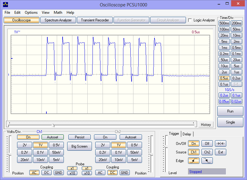

So just for kicks, I initialized the structure withSPI_InitStructure.SPI_DataSize = SPI_DataSize_4b;
And this is the result (SPI clock)2015-06-24 8:32 AM
