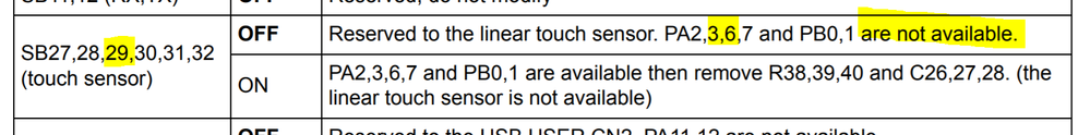

PA6 is not available at the pin header by default as it's connected to the linear touch sensor. It requires some reconfiguration to expose it at the pin interface.
The user manual has a good amount of information on this and other things:

Which MISO pin was the "not working" one? Isn't the MISO pin in question connected to some resource/pin/button/etc. on the board?
2020-12-31 9:41 AM
The "not working" pin is PA6. I'm not entirely sure what else it's wired up to. If it is wired to something else that's preventing me from using it, why would they break out that pin to a header on the board in the first place?
2020-12-31 9:55 AM
2020-12-31 11:15 AM
Ah well that'll do it. Pretty frustrating how hidden that detail seems to be. I feel like something like that be made more visible and clear in the user manual. I mean now it makes sense that its located in the solder bridge section and I'll know to look there from now on, but for someone new to embedded programming like me, if I was looking to use SPI on the dev board, I would intuitively look for a section on SPI or PA6 pin, not the solder bridge section and linear touch sensor. There's a whole section on the pins and their functions, why not make some kind of comment there or have some kind of asterisk to bring your attention to it! I did scan the document a couple times before but you can't even find it if you use ctrl-F to search for 'PA6' because of the comma and other pins they use between PA and 6.
