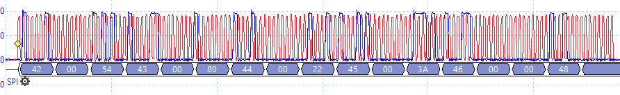

All bytes are right until the 46 00 00. The next should be 48, but is 00. From then, all bytes are wrong. The strange thing: If I set a breakpoint befor the SPI_Transmit command and make one step forward, it works:
My idea was that it has something to do with a full buffer. So I reduced the number of bytes. The strange thing: Only sendig 16 bytes gives:
The B8 is the first wrong byte. But increasing now to 17 bytes:
At this point, my buffer theory makes no sense anymore because this is a correct transmission.
