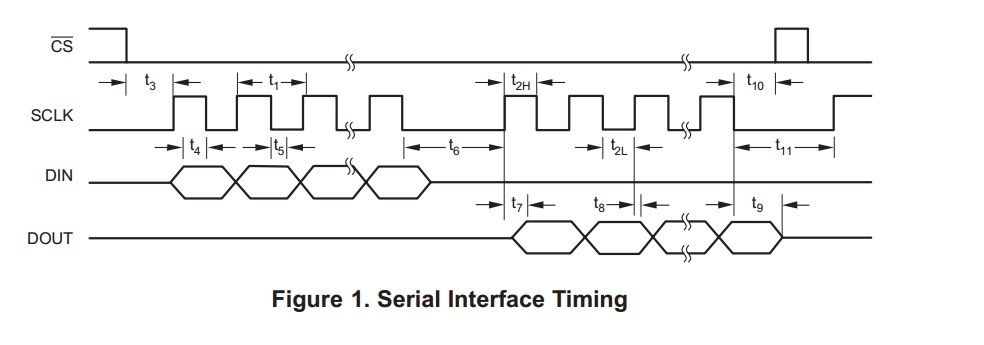

I wanna know if its possible to use DMA SPI for drive the ADS1256 or similar where I can ''stop'' the tranfer to wait until the time to convert T6 (Delay from last SCLK edge for DIN to first SCLK) of the ads.I tried a interrupt in TX (with a TC flag and a fuction hanlder) but it wont resolve the problem, the SCLK doesnt stop.2013-01-30 2:05 AM

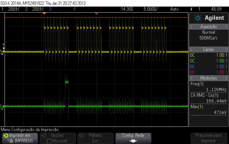

Thankswaclawek.jan for the reply. I give up from DMA and now I am trying with normal SPI. And guess what? More problems. :( The clock appear with a latency that I can take off by removing ''while (SPI_I2S_GetFlagStatus(SPI1, SPI_I2S_FLAG_RXNE) == RESET);
But when I do that I read wrong the data. The 3 last bytes is what I have to read from ADS1 The first byte is the command for read the conversion (ADC). Here's the code:/* SPI1 configuration ------------------------------------------------------*/

And here's the latency. If I use the
SPI_BaudRatePrescaler_32; on 128 the latency go away. But its too slow.
