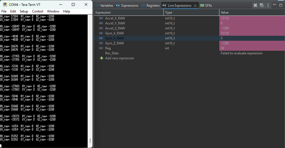

2025-09-29 6:11 AM
I tried reading the values via UART using Tera Term, but the problem persists.
However, the initial values are now different from before, and the X-axis values swing from negative to positive now. The fact that the values now change by a different amount is related to the additional delay introduced by the UART transmission.
In the code where I didn't use Tera Term when I changed the HAL_Delay(250) to HAL_Delay(500) in the while(1) loop, the X-axis values started changing by a larger increment, and the Z-axis value became -2815 instead of the previous -1280.
void MPU6050_Read_Accel(void) {
uint8_t Rec_Data[6];
char msg[64];
// Read 6 BYTES of data starting from ACCEL_XOUT_H (0x3B) register
HAL_I2C_Mem_Read(&hi2c1, MPU6050_ADDR, 0x3B, 1, Rec_Data, 6, 1000);
Accel_X_RAW = (int16_t) (Rec_Data[0] << 8 | Rec_Data[1]);
Accel_Y_RAW = (int16_t) (Rec_Data[2] << 8 | Rec_Data[3]);
Accel_Z_RAW = (int16_t) (Rec_Data[4] << 8 | Rec_Data[5]);
Ax = (float) Accel_X_RAW / 16384.0;
Ay = (float) Accel_Y_RAW / 16384.0;
Az = (float) Accel_Z_RAW / 16384.0;
snprintf(msg, sizeof(msg),
"AX_raw= %d AY_raw= %d AZ_raw= %d\r\n",
Accel_X_RAW, Accel_Y_RAW, Accel_Z_RAW);
HAL_UART_Transmit(&huart2, (uint8_t*)msg, strlen(msg), HAL_MAX_DELAY);
void MPU6050_Read_Gyro(void) {
char msg[64];
// Read 6 BYTES of data starting from GYRO_XOUT_H register
HAL_I2C_Mem_Read(&hi2c1, MPU6050_ADDR, 0x43, 1, Rec_Data, 6, 1000);
Gyro_X_RAW = (int16_t) (Rec_Data[0] << 8 | Rec_Data[1]);
Gyro_Y_RAW = (int16_t) (Rec_Data[2] << 8 | Rec_Data[3]);
Gyro_Z_RAW = (int16_t) (Rec_Data[4] << 8 | Rec_Data[5]);
Gx = (float) Gyro_X_RAW / 131.0;
Gy = (float) Gyro_Y_RAW / 131.0;
Gz = (float) Gyro_Z_RAW / 131.0;
"GX_raw= %d GY_raw= %d GZ_raw= %d\r\n",
Gyro_X_RAW, Gyro_Y_RAW, Gyro_Z_RAW);
I added only snprintf and HAL_UART_Transmit to functions that read the values of the sensor.
So here are the results in Tera Term. Values are the same as Live Expressions show it.
