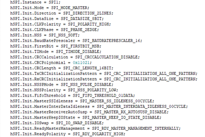

This is my SPI Configuration.

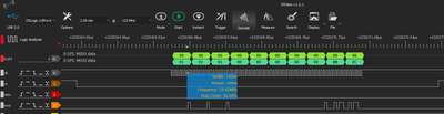

Upto a clk freq of SPI_BAUDRATEPRESCALER_16 (250/16 = 15.625 Mhz), my SPI transactions work i.e the 10 bytes I send from Master are coming up on the MOSI line. And my slave also behaves correctly.

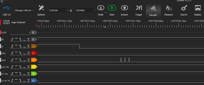

However, for frequencies above that (say SPI_BAUDRATEPRESCALER_8), the clock pin does not show any pulses!!
