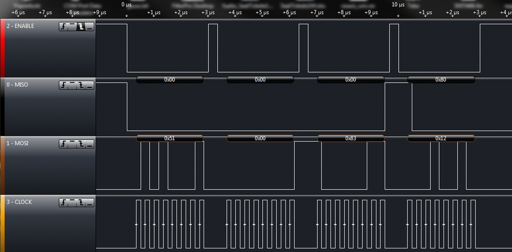

Actually I was able to get to a sufficient solution after rereading the Programming Manual, Reference Manual and the datasheet of the STM32F051. I now use the NSS pulse mode and SlaveSelect pin (NSS) operated by hardware. So I had to init the NSS pin als alternate function 0, earlier I used the NSS pin as GPIO output and pulled high and low per software. As a sidenote, one has to use the SPI_X related fixed NSS pin then, which I already did. See here a saleae screenshot of a 4 byte consecutive byte transfer that now is L6470 compatible and quick, I guess the fastest L6470 allows.We’re moving the ST Community to a new platform to give you a better and more reliable community experience.
