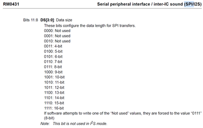

I have a rather strange request, but I am communicating to a Digital Potentiometer (AD5227) over SPI.  The chip has 64 available positions, but can only increment or decremement its position by 1 for each clock cycle.  To increment by 1, a 1 is placed on the MOSI, and to decrement a 0.  The issue is that to increment by 1 over SPI (8-bit) I have to send, 10101011, which is inefficient.  I hoped I could change this to 1-bit, but I am limited to a minimum option of 4-bits in STMCubeIDE.  Is it possible to change this to 1-bit?  I also then need to change it back to 8-bits for the other devices on the SPI.  I am unfortuantely limited by the number of pins available on the MCU otherwise I would use 3 more dedicated pins to communicate to this chip.  Thanks for your help

No, the lowest word size for the SPI on the F7 is 4 bits. CubeMX is enforcing a hardware limitation.

Indeed, it is somewhat cumbersome to operate such 1-bit interfaces with SPI. Nevertheless, it should still be feasible if you set an odd number of bits instead of an even number of bits for single steps. By the way, this is why your sequence 10101011 will increase the pot by two steps instead of one, because in this case the first 6 bits cancel out and only the last two bits are effective. Instead, you could set the SPI port to 5 bits and achieve the desired result with 1010x and x=setpoint.
For two or an even number of steps to be set simultaneously, the SPI would then be set to an even number of bits.
