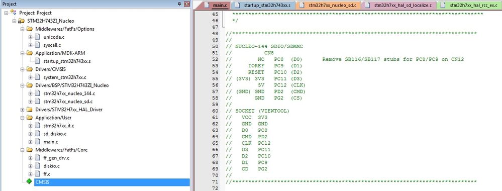

My approach has been to port the HAL code from the STM32H743xI-EVAL board to the NUCLEO-H743ZI, creating a stm32h7xx_nucleo_sd.c

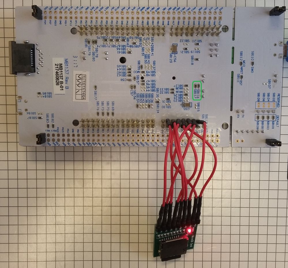

First of all, it works like a charm! (some issue about permissions but that's not a big of a deal now!)I remove as mentionned before the '0ohm' resistor on pin SB116 and SB117 and ... well it makes things work! if also changed a bit two functions :FATFS_LinkDriver(&SD_Driver,(TCHAR const*)SDPath)
FATFS_LinkDriver(&SD_Driver,'')f_mount(&SDFatFS, (TCHAR const*)SDPath, 0)
->f_mount(&SDFatFS, '', 0)I keep things simple here to start understanding how things work!
thank you Clive for the help you provide me!
