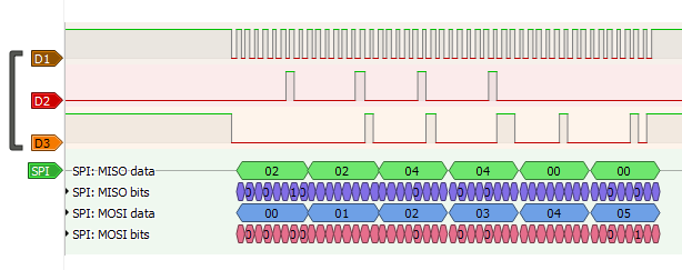

You are right, the swap is pointless and it is true that there is a delay of one byte, but that is not exactly my problem. The second byte that the slave sends should be the first of the master, but it's different.
2019-09-25 4:25 AM
I tested it with a slave that should transfer a 5-byte array from the master. The slave sends data that are not shifted by one byte, but wrong values.
