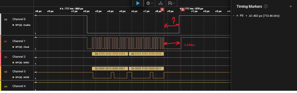

I am working with SPI1 on stm32f407vgtx and issue what I am, facing my NSS which internally controlled by SPI is taking more time for goes high even CLOCk has been stopped . my configuration are SPI full duplex 16 bit data clock is 2.6MHZ after prescaled I am transmitting on spi every 10ms task. Please check the screenshot of logic analyzer for further understanding .
Note: in the end I have disabled SPE bit before checking TXE and busy flags.

The issue we see is additional ~1.5 us is taken by SPI controlled CS to go to High after Clock stops.To make CS high SPI is disabled via bit SPE =0 in CR1 after TXE = 1 and BSY= 0
Note : Please check once the image that I have shared.

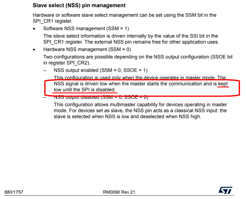

The SPI hardware does not set NSS (CS) high actively.
If you use Cube/HAL, it probably disables SPI entirely (by clearing SPIx_CR.SPE) after transmission. This threestates the SPI pins, i.e. does not pull them up actively, although you mayu have enabled internal pullups on the NSS (CS) and SCK pins.

As @waclawek.jan suggests, the defined behaviour is that CS stays low until the SPI is disabled:
via: https://www.st.com/en/microcontrollers-microprocessors/stm32f407zg.html#documentation
@Ash1 wrote:
- Why additional time needed and what is the functionality executed in this period?
the delay you're seeing is probably the time that it takes to disable the peripheral.
At zero optimisation (which is the default for the STM32cUBEide Debug configuration), stuff can be very slow - especially HAL stuff.
So what optimisation level are you using?
It may or may not be quicker to manage the CS "manually" using HAL calls (also subject to optimisation, of course).
It probably would be quicker to do it via direct register access.
