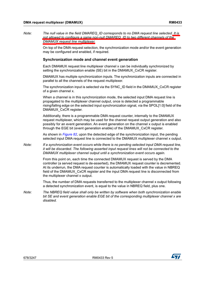

And also the mux selection is exclusive (i.e. only one request line can be selected at a time for one DMAMUX channel), so you can't triger one stream from multiple requests (unless they are merged before DMAMUX in internal fabric, which as far as I can see they are not).

Yes I've read this note before, but was not clear to me.
Any way, It seems that you are right and what I want to do is not possible.
I have to try some work around solutions.
