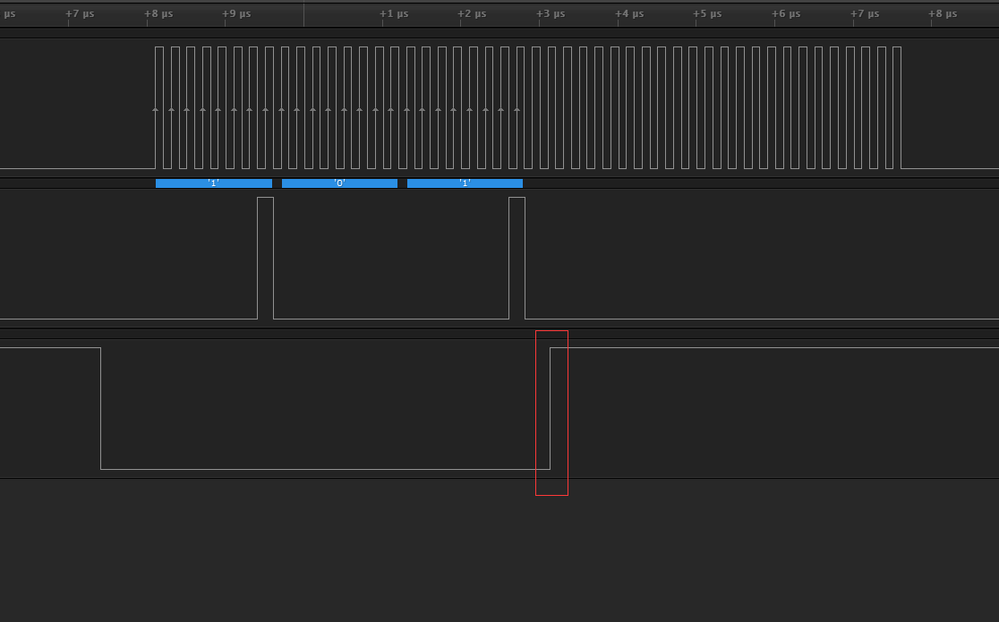

hi,I want use SPI1 as master and SPI1 reg configure as that
SPI1->CR2 =
0x1704
; SPI1->CR1 =0x15C
;read code is
GPIOA->BSRR |=
1
<<20
;//set NSS low
for
(i =0
;i < command_size;i++){
while
(0
== (SPI1->SR & SPI_SR_TXE)); SPI1->DR = out_buf[
i]
&0xFF
;while
(0
== (SPI1->SR & SPI_SR_RXNE)); in_buf[
i]
= SPI1->DR &0xFF
GPIOA->BSRR |=1
<<4
;//set NSS high
i use logic analyzer capture the logic as
it saw that clock also driver after NSS set high.
can anyone help me
#stm32l431-spiSolved! Go to Solution.

Release NSS only when SPI BUSY bit is cleared.
2017-03-10 2:00 AM
thank you for reply, my problem is that when i send 3 bytes but it have 48 clocks
