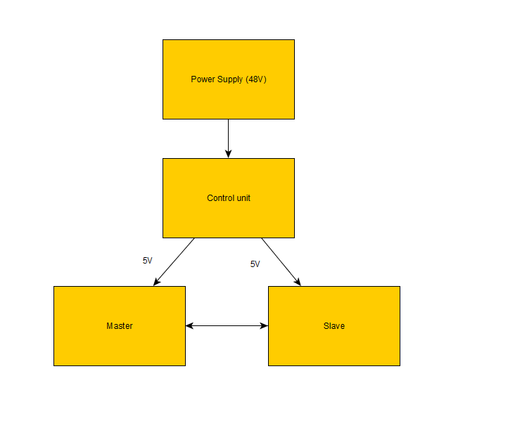

Does the interference stop when the sensor is disconnected ? -> If the sensor (slave) is disconnected, the communication will also be disconnected. Added to that, the sensor is actually powered by the control unit, which is also powering the master. Hence, If I disconnect the sensor, I will disconnect the power to the sensor as well.
Are there any ground loops ? -> Nothing I know of. The master and the slave share the same ground with no evident ground loops in sight.
What is the power source ? -> Power source is from a standard power supply with 48V input to the control unit. It steps down the voltage to 5V, which is used to power the sensor (slave). The slave has an 3.3V LDO, which is used to power the microcontroller. A similar setup is used on the master side as well. Since the master and the slave are spaced out by a distance of around 15 cm, individual LDOs are used.

 Also in the above block diagram the slave should take 5V power and ground from the master
