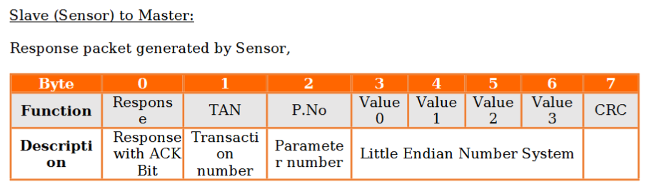

Communication Protocol
The protocol for the communication is as follows.

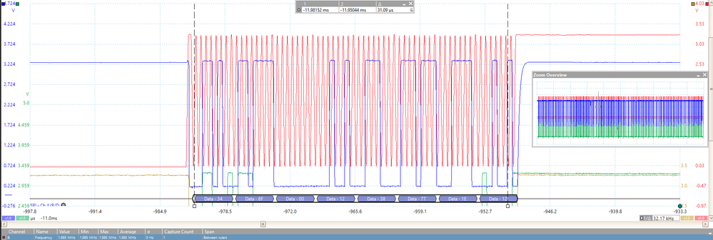

From the above picture (measured data from picoscope), the decoded SPI message from the MISO line is as follows,
0x34 0x6F 0x00 0x12 0x38 0x77 0x1E 0x12
For CRC, I am using the XOR checksum (CRC8). When I check the above message for the validity (using a normal xor checksum calculator online), the xor byte becomes invalid (0x12)

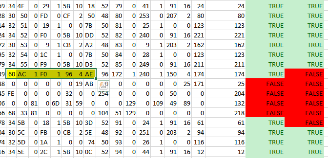

For example, take a look into the above highlighted transaction.
The decoded MISO message is 0x60 0xAC 0x01 0xF0 0x01 0x96 0x04 0xAE. The complete packet is shifted to the left by exactly 1-bit. If I shift the message by 1-bit to the right, I receive the following message -> 0x30 0x56 0x00 0xF8 0x00 0xCB 0x02 0x57. This is a valid transaction and the message holds true.

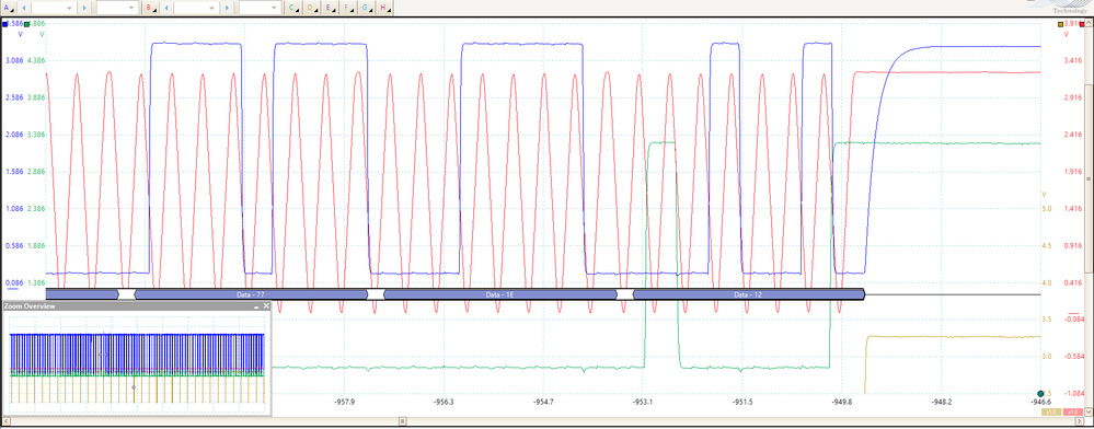

I did almost the exact measurement you suggested. I used special shielded cables, which were directly soldered onto the SPI connectors, with GND shield connected to the microcontroller GND. The bandwidth of the oscilloscope I used is around 70 MHz (12-bit resolution).
BLUE -> MISO
RED -> CLK
GREEN -> MOSI
Even I suspected such a "glitch" on the CLK line might be the culprit, but I was unable to capture this on the scope. There, the CLK signals looked fine. Even if we consider that such a glitch occurs on the CLK line, it should affect not only MISO but also MOSI. Right?

SCK is generated by master, so it's output (MOSI) is probably derived from internal version of SCK and unaffected (in STM32 it's not this way and MOSI is generated from a feedback from the SCK pin, but that's IMO a deviation, I've never met this approach before).
The SCK is suspiciously slow. slower than MOSI. Is there any way to make it's slew rate higher, maybe a pin setting in a master? Is there any extra hardware on SCK?

what is the idle state for clock? in picture it starts from low state but ends with high state. is this correct? make sure no clock edges are ignored.​

Thank you for your response. I am using a RC filter at the slave, with a cut-off frequency of 340 MHz and RC Time constant of 5e-10 seconds.
Unfortunately, I cannot change any settings with the master. There are only the RC components on the SCK and nothing else.
Yes I've noticed that too, but CPOL=1, and there is a (barely noticeable) yellow trace which is probably NSS - within it, the clock is already high at the start, so that should be OK.
Also, the bit shift occurs midway in the message. Would the idle state of SCK the culprit, the shift would occur at the beginning.
