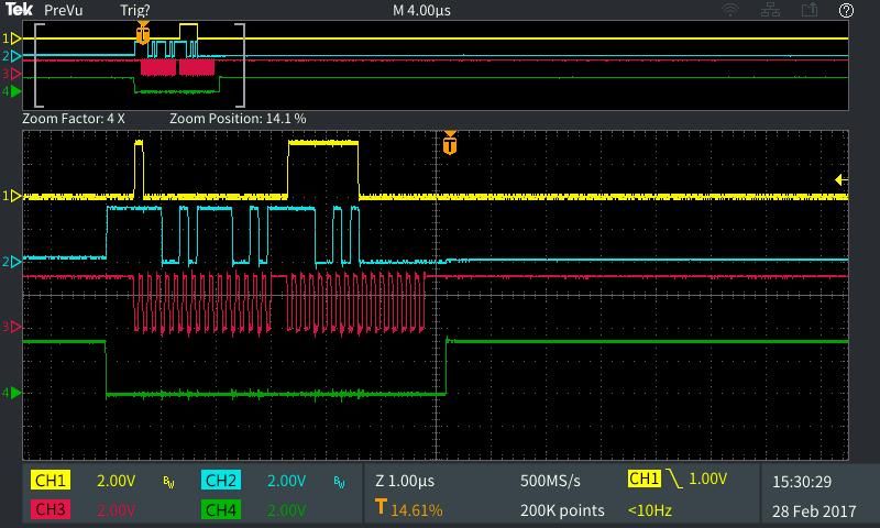

I've selected 8 bit data size, but am seeing 16 clocks on a scope. I use a read function to read address 0x00, the device's ''who_am_I'' register, and get 0xE5 back. In theory this is ok.
However, I see the image here:
Yellow = MOSI
Cyan = MISO
Red = CLK
Green = _CS
The accelerometer is replying <0xE5> 3 times (trace 2 in cyan) because of this 16bit data size. If I set it to 4bit data size, I get 8 data clocks. But then I get a nybble in the low byte and a nybble in the high byte.
https://community.st.com/0D50X00009XkeupSAB

2017-02-28 8:18 AM
So after just showing a colleague, we tried transmitting just one byte. I still get the 0xE5 in the data register as expected, and this time there are only 16 clock cycles, as expected normally.
But what if I want to read 2 bytes?
Address +byte1 + byte2 = 3 bytes. But I would be sending 4, or most probably 6, because any write to the DR incurs a 16clock transmit overhead.
Please tell me this is not a bug, so I can continue to investigate this part for our inverters. DP FPU, 200MHz, triple interleaved 12bit ADC ticks all my other boxes.
2017-02-28 8:19 AM
It seems that a physical write on the DR must be 8 bit, otherwise, the MSB and LSB will be queued onto the FIFO and 2x8bit will be transmitted.

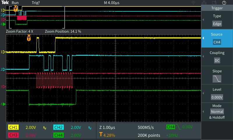

Fixed it:
* Accelerometer SPI layer data transfers * */uint8_t readByte(uint8_t addr){ static uint8_t* spiDrPtr = (uint8_t*)&SPI4->DR;ACCL_CSLO();
delayLoop(5); // small CS wait*spiDrPtr = addr|0x80; // Reading from addr
while(!(SPI4->SR & SPI_SR_TXE)){}; // Wait for empty bSpiData = *spiDrPtr; // Read rcvd data*spiDrPtr = 0xFF; // Write 2nd byte
while(SPI4->SR & SPI_SR_BSY){}; // bSpiData = *spiDrPtr; //ACCL_CSHI();
delayLoop(10); // post CS delayreturn bSpiData;
}Resulting in:
And as for why it replies 0xE5 during the first byte, I don't know/care atm.
