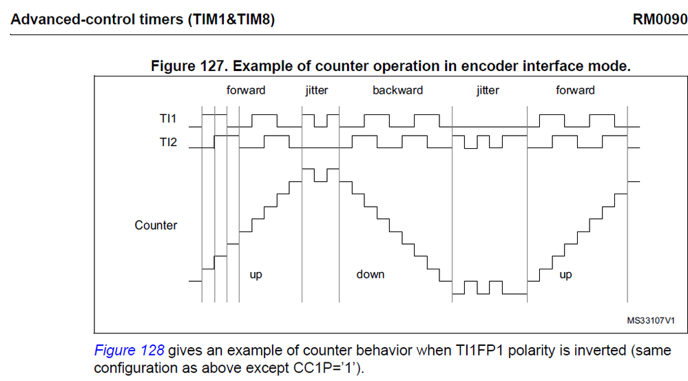

The STM32F4 timers can be used in encoder mode, which is meant for measuring exactly this.
You would hook up one signal to CH1 and the other to CH2 and configure the timer in encoder mode. Then read the CNT register value to get the current position.
