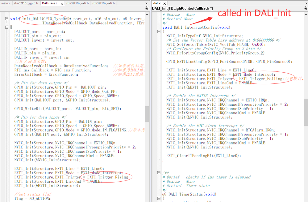

DALI_RX port and DALI_TX port have been initiated twice in" void DALI_Init(TDLightControlCallback LightControlFunction) " and "init_DALI(OUT_DALI_PORT, OUT_DALI_PIN, INVERT_OUT_DALI, IN_DALI_PORT, IN_DALI_PIN, INVERT_IN_DALI, DALI_Interrupt, DALI_Error, Lite_timer_Interrupt)",and between them, one of interruption of PB0 is "EXTI_Trigger_Falling"and other in init_DALI is "EXTI_Trigger_Rising" .

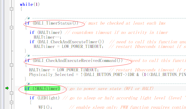

The GPIOB0 of stm32f1x board has been give data which is '1 0011 0001 0010 0100 11' from other board every stable time, but the STM32_Slave do nothing in main() ,but do 'if'.
:persevering_face: hoping somebody can help me!!!
