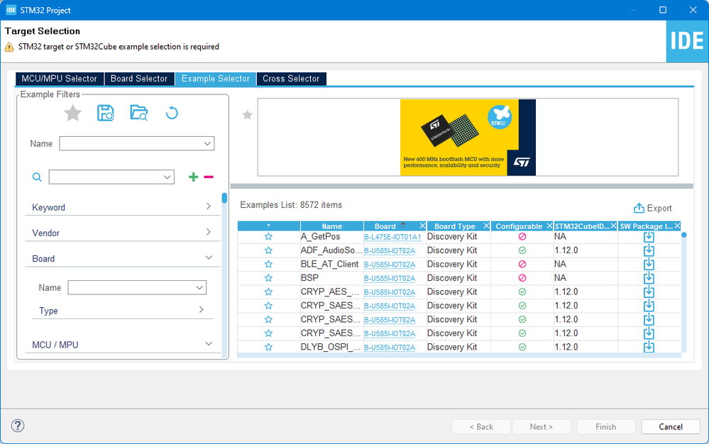

2024-07-16 9:51 AM - edited 2025-04-14 3:56 AM
@Andrew Neil wrote:Correct - they don't all have a .ioc file.
I think the 'Configurable' column tells you which is which:
for the ones which do have a .ioc file;
for the ones which don't.
PS:
This, of course, doesn't stop you from re-configuring the project - it just means that you have to do it directly in code, rather than though the CubeMX GUI.
In most cases, the so-called non-configurable (sic) ones will have a Board Support Package (BSP) to abstract the hardware details and, thus, facilitate re-configuration.

2024-07-16 8:02 AM - edited 2025-05-15 1:51 AM
Some just have C initialisation code for the clocks, peripherals, etc - see here.
@FBerg.1 wrote:How can I enable the view "Device Configuration Tool" for that example project?
You can't.
@FBerg.1 wrote:Or: what's the best way to see the Mikrocontroller resources used by that project?
Just have to browse the code to see what's used.
If the example in question is for an ST board, then MXCube should have awareness of that board ...
PS:
