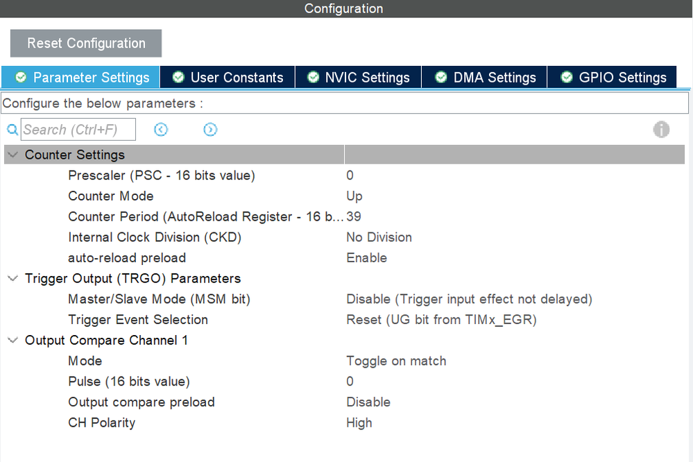

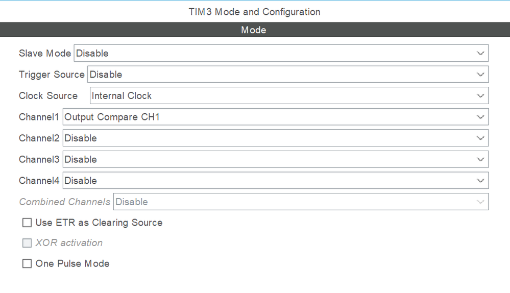

I configured TIM3's output cmpare function with the Channel1 enabled.
I configured the parameters as follows:
PSC=0,
ARR=39,
Output Compare Channel1: Mode = Toogle on match, Pulse=19
The frequency of TIM3 is 40MHZ.
As I understand it, when I configure the output compare function of TIM3 according to the above parameters, the output pin of channel 1 should generate a square wave with a period of 1us. Because Pulse/40MHZ = 20/40MHZ = 0.5us.
But actually, I get a square wave with a period of 2us. After my troubleshooting, I realized that this value is calculated based on the value of ARR. Because ARR/40MHZ = (39+1)/40MHZ = 1us.
In fact, I found that the parameter Pulse didn't do anything at all, and even if I set the Pulse parameter to 0, the Channel1 pins would still generate a square wave based on the value of the ARR, as well as generating an interrupt.
Can anyone explain this? Why doesn't the parameter Pulse play any role, instead ARR determines the period of the output square wave? As I understand it, it should be that ARR plays no role and Pulse determines the period of the output square wave.

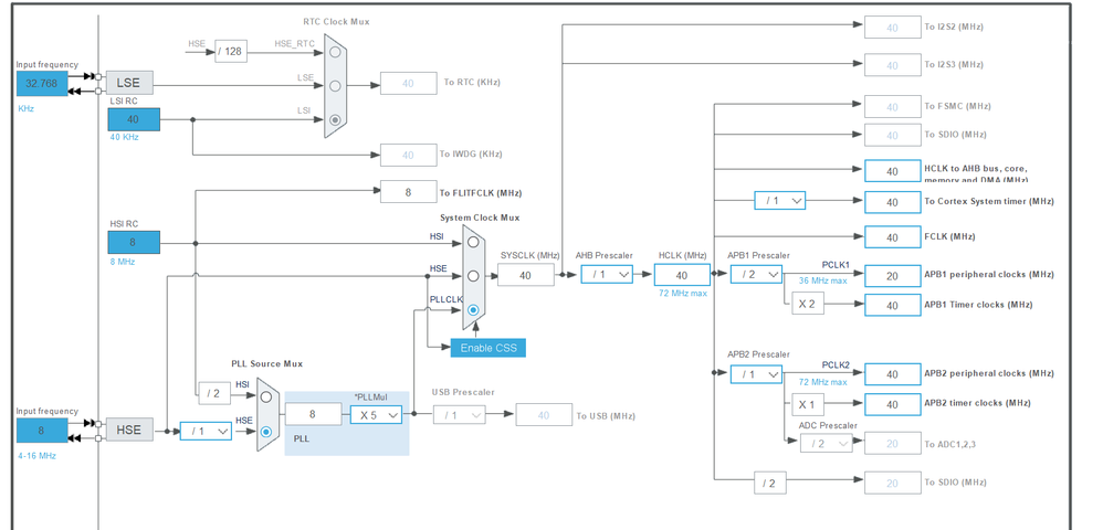

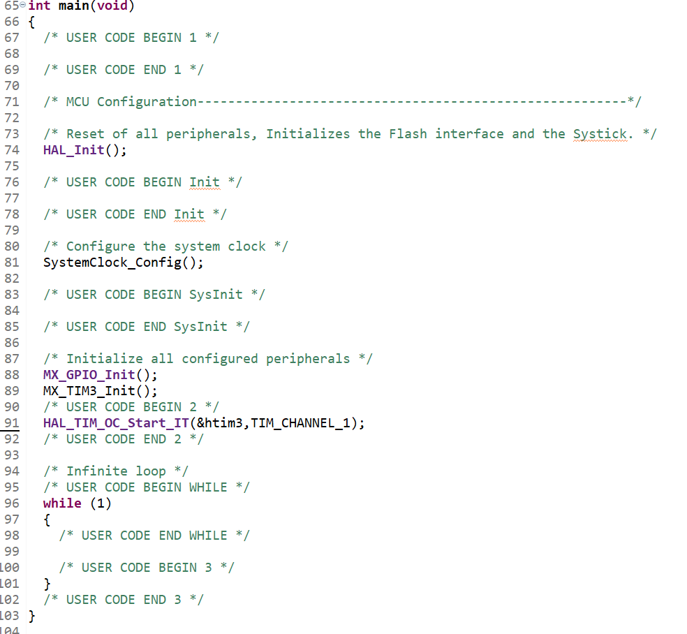

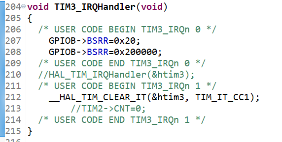

My clock configuration, and part of the code is shown below:

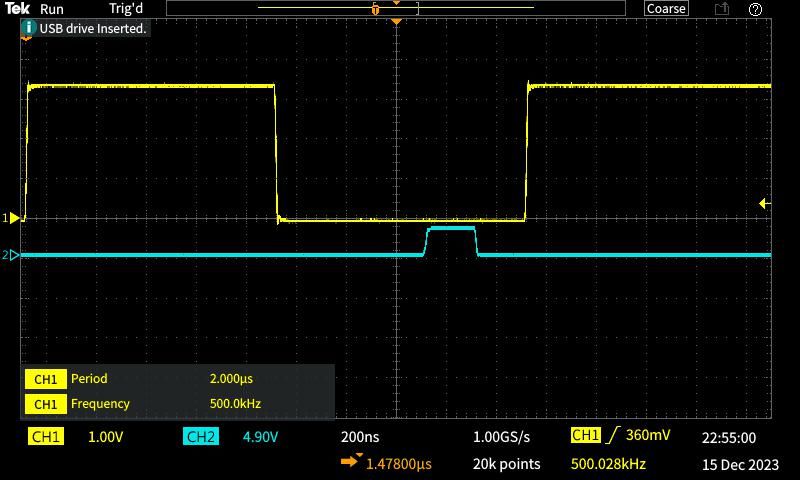

Following the configuration above, the waveform I got from the oscilloscope is shown below. Where the yellow waveform is representing Cnannel1 of TIM3 and the blue waveform is representing GPIO PB5 which is flipped in the ISR of TIM3.

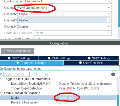

You have it set to toggle on match, so it toggles once per period, when the count matches.
Instead, set it to PWM mode 1.

Hello @MasterLu, welcome to ST Community,
Just to make things more clear for you regarding the ARR and pulse values...
This is how the output compare function works; ARR sets the top value of the timer (When the timer's counter reaches this value, it resets to 0), whereas, the pulse value you set for the OC channel is compared with the counter value (when the counter reaches the pulse value, the output pin is toggled)
For example, in toggle on match, if counter=pulse, the output is toggled but the counter doesn't reset until it reaches the ARR value.

Yeah, you're right. However, the problem I'm currently having is that it doesn't work no matter what my pulse parameter is set to. And the ARR parameter seems to do what the pulse parameter is supposed to do.
As an example, whether my pulse parameter is set to 20 or 0, the period of the square wave I observe on the oscilloscope doesn't change in any way. When I set the ARR parameter to 39 or 65535, the period of the square wave I observe on the oscilloscope changes.
As I understand it, the period of the square wave I observe on the oscilloscope should change when I set different values of pulse.
