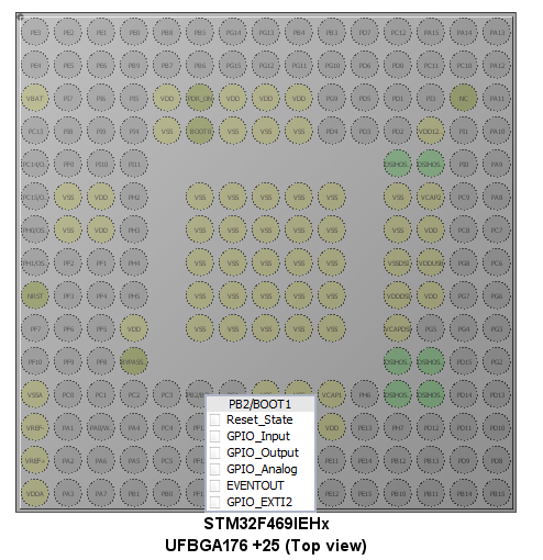

Taking the example of the STM32F469IEHx where PB2 is indicated as BOOT1, you don't have the signal BOOT1 on PB2 as once BOOT1 has been sampled, the corresponding GPIO pin can be freed and used for other purposes :
In the <LINK NO LONGER ACTIVE>
, the boot configuration is well described.
BR. Jeanne

Ok, so it looks like for the F469IEHx CubeMX correctly indicates that PB2 is also BOOT1. How come that doesn't happen on the F413CHUx in my example?
