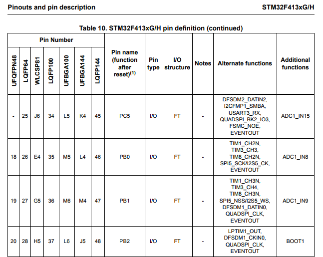

,Regarding the pinout config, the data sheet is our reference. If you have a look to the data sheet for the STM32F413 (
http://www.st.com/en/microcontrollers/stm32f413vh.html
), the PB2 pin is named PB2 and has BOOT1 as additional functions :So, the name of this pin is correct on CubeMX and you can find the information of where Boot1 is mapped with the data sheet.

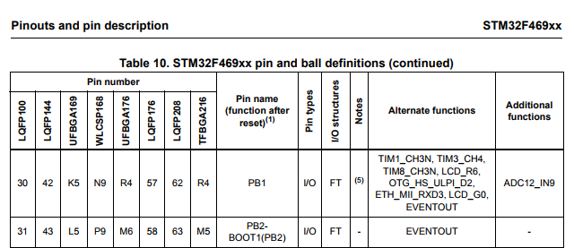

For other MCUs as STM32F469, the name of the PB2 is PB2_BOOT1 as seen in the data sheet :
I hope I have answered your question.

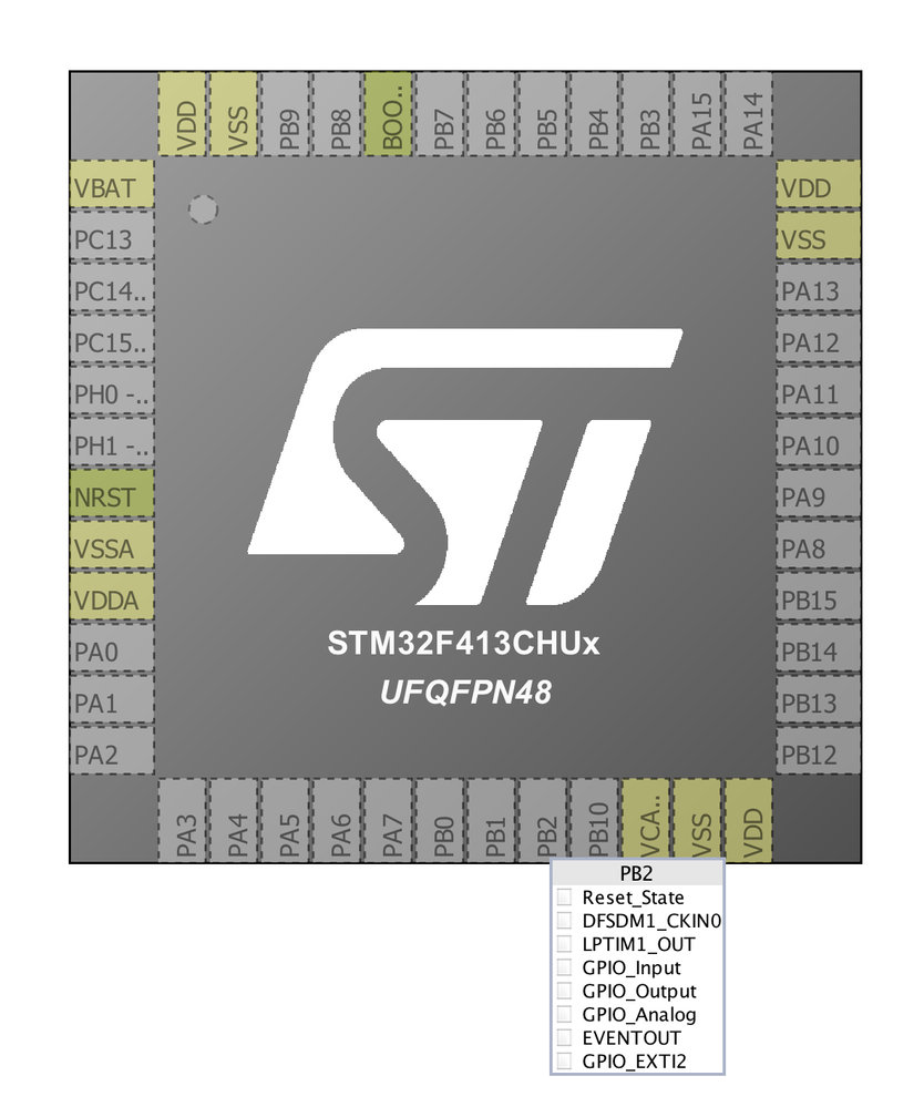

No, this absolutely does not address the issue. Look at this screenshot from CubeMX:
Nowhere does it indicate that PB2 has an additional function of being the BOOT1 pin. If you click on a pin which also serves as an ADC input (which is an additional function) that's indicated in the popup menu. But there's absolutely no indication that PB2 also serves as BOOT1. Yes, this can be looked up in the datasheet, but the purpose of the software is to assist you in the design of a pinout for the processor and it's omitting crucial information.
