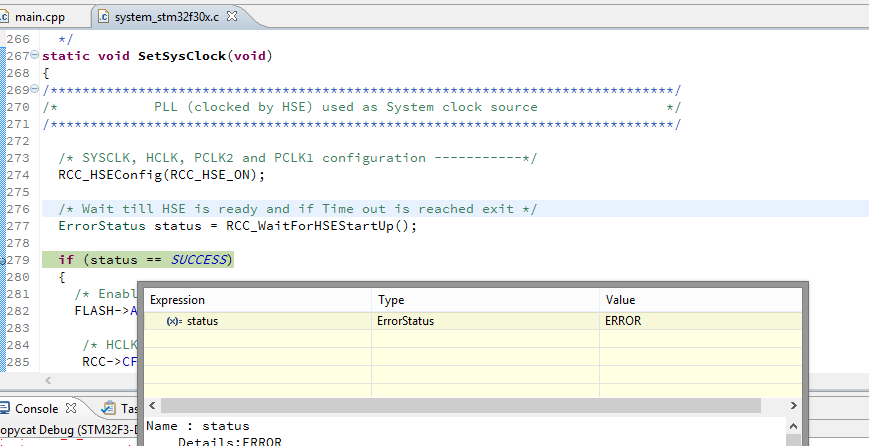

. The project is nothing fancy, basically a default project generated from GNU ARM Toolchain for Eclipse.However, in theSetSysClock()
code (), the loop that waits for the HSE to become ready always times out, so I'm stuck with the 8 MHz internal oscillator.I triedRCC_HSEConfig(RCC_HSE_ON)
as well asRCC_HSEConfig(RCC_HSE_Bypass)
(which I assume is what I need), to no avail. This is on a plain F3-Discovery, i.e. only the 8 MHz osc from the ST-Link, no osc on X2.Am I doing anything wrong?2015-02-20 8:48 PM

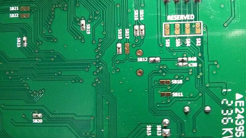

And you have the appropriate SB (solder bridges) configured to connect the 8 MHz signal from the F103 part?
SB12 is OFF by default.2015-02-20 9:00 PM
If I understood that correctly, SB12 should be closed, SB17 open and R33 open as well. Should be the case, this is how it looks like on my board:

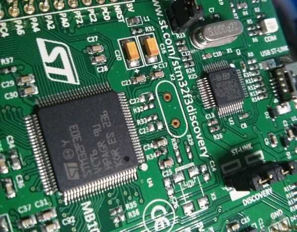

STM32F3-Discovery_FW_V1.1.0\Project\Peripheral_Examples\ADC_Example\system_stm32f30x.c You might also what to check the signals with a scope, and direct the HSE signal out the MCO (PA8) pin, to see what the core sees.2015-02-21 6:36 AM
Thank you so far! The ADC example code very much looks like what I did already (and I'm glad about that! :))
I tried it nevertheless just to be sure, but it didn't work, that is, didn't change anything. As for measuring the clock via PA8, I used the following code.void

and my logic analyzer only samples up to 24 MHz, so I tested with several sampling rates to rule out aliasing ... without success. WithRCC_MCOSource_HSE
there's always flatline. When I useRCC_MCOSource_HSI
orRCC_MCOSource_SYSCLK
instead, I can see a wobbly, but good-enough 8 MHz waveform. So, from what it appears, the F3 doesn't even get any clock from the F103?2015-02-21 7:21 AM
Humpf ... from what it seems, the R48 resistor is dead.
