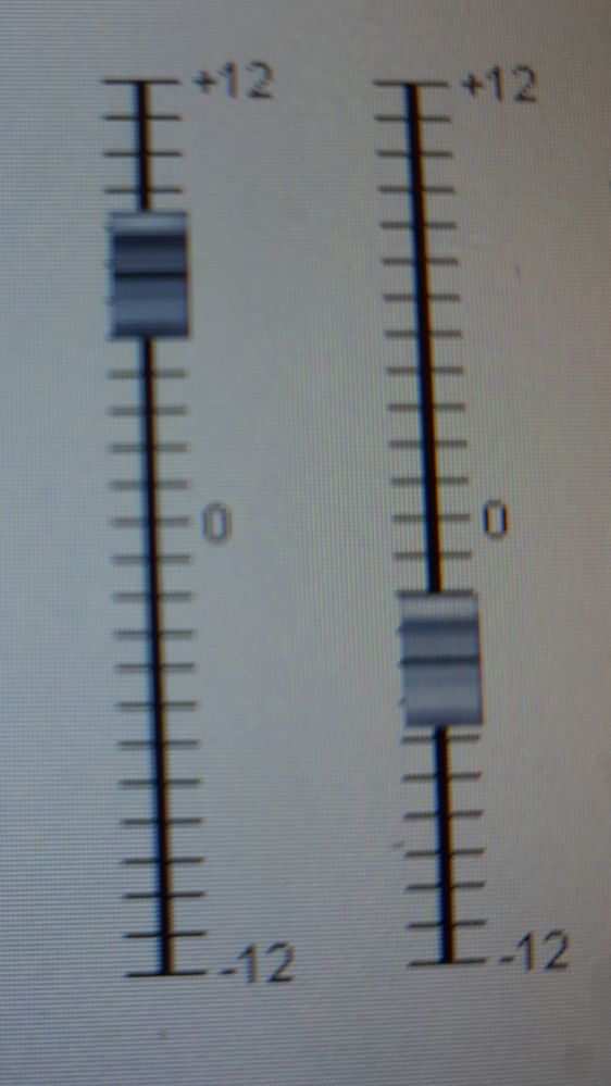

0693W000000UjCvQAK.jpgHere my solution to create a slidebar on this evaluation board, it should run also in other STM32 modules.

slidebar_Struct slidestr1 = { SLIDE_X, SLIDE_Y, EMPTY_Y, 1, 0, 0, 0, 0, 0 };
slidebar_Struct slidestr2 = { SLIDE_X - 60, SLIDE_Y, EMPTY_Y, 1, 0, 0, 0, 0, 0 };

        	    BSP_LCD_CreateSlideBar(&slidestr1, (uint8_t *)(&slide1), (uint8_t *)(&cursor1), yDiff, 0);
        	    LCD_LOG_State("Cursor 1 now at position  %d%%",  slidestr1.curr_pos);
		if (ts.touchX[0] > slidestr2.cursor_start_x && ts.touchX[0] < slidestr2.cursor_end_x  &&
        	ts.touchY[0] > slidestr2.cursor_start_y && ts.touchY[0] < slidestr2.cursor_end_y)
			if (yDiff < 100 && yDiff > -100 && yDiff != 0)
        	    BSP_LCD_CreateSlideBar(&slidestr2, (uint8_t *)(&slide1), (uint8_t *)(&cursor1), yDiff, 0);
        	    LCD_LOG_State("Cursor 2 now at position  %d%%",  slidestr2.curr_pos);
